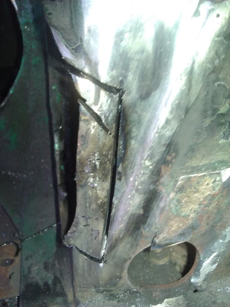

I had a good day yesterday and managed to get the gearbox pretty much where I want it to be.
I had to notch the subframe to allow the gearbox move across.
Its a bit of a snug fit....

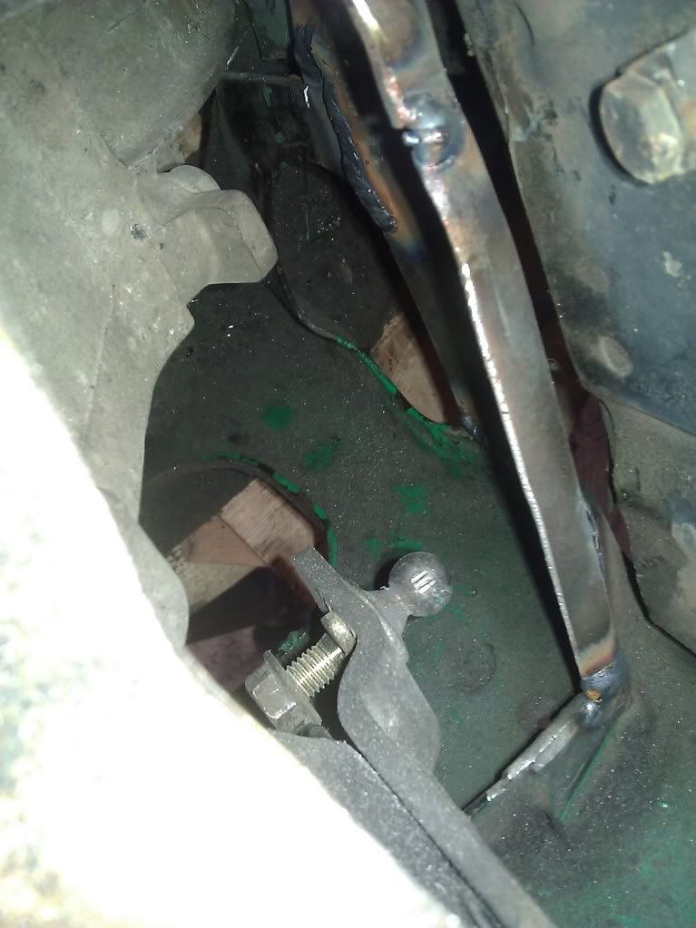

Then had to trim back to increase clearance for the gear change
Plenty of space.
And cut a small notch to clear the diff housing.
Then trim out the tower hole to clear the CV boot.
